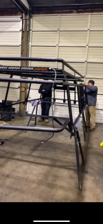

12/4/23. Update… wow it’s been a bit…. Ended up repainting the top as the clear was chipping off and after removing the ladder and luggage rails we wanted to reseal.. plus we are adding a full custom fabricated roof rack and want paint done before install.. lower band of the van got black raptorliner, along with bushmaster flares. I built the move front and rear bumpers and had those raptorlined, the van was brought to a shop in Oregon for the 4x install and custom fab work..
Fabrication: custom one off full roof rack, weld tabs for 8 flood lights at the perimeter, weld tabs for front and rear light bars with secondary amber running lights (markers for whiteout snow) roof rack will hold a full size spare! Yikes!! surf poles, custom ladder to be located on driver side. Custom wide metal running boards for snow boots.
