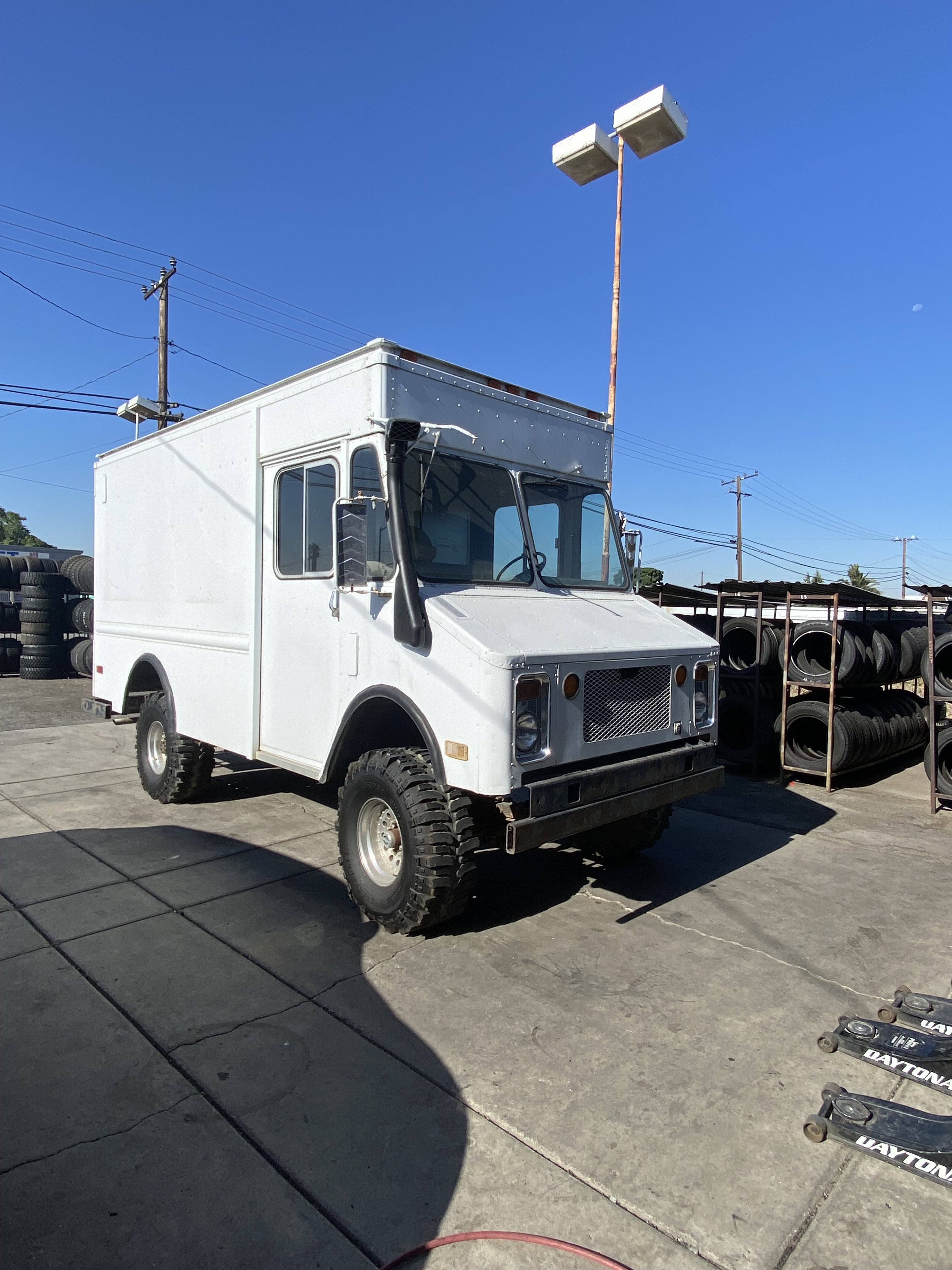

I was open to any of the cab over trucks as that is what I liked. I too spoke with Roly but just never felt like I would get responses in a timely manner which is why I did not continue with him and yes Dana 60 was the plan for the front. I came across a great opportunity with another box truck that someone had already converted to 4x4 so I jumped on it and sold my NPR. I will start working on my box truck soon I might try and document on you tube. What truck are you trying to convert?

I was open to any of the cab over trucks as that is what I liked. I too spoke with Roly but just never felt like I would get responses in a timely manner which is why I did not continue with him and yes Dana 60 was the plan for the front. I came across a great opportunity with another box truck that someone had already converted to 4x4 so I jumped on it and sold my NPR. I will start working on my box truck soon I might try and document on you tube. What truck are you trying to convert? View attachment 840396
Oh hi. Well my daydream is an NQR or NRR crew cab with the 176" wheel base. A couple of guys have said they are not great on the highway... Im just a Haynes repair manual guy and was thinking of getting Roly to sell me a 'kit', parts list, fabricated items, and instructions, but he isn't interested. I am in Victoria BC so very far from Miami. I was just curious what front axle would be the next step or two up for GVWRs higher than the NPR...

I ran into quite a few Isuzus converted and they all seem to use the dana 60. I think they use it more because it is widely available. A lot of super dutys out there you know. If money was no issue I would probably go with Dynatrac axles but I think the dana 60 is sufficient. There is no kit no where out there I searched far and wide. For cabovers you must fabricate. You will need a front axle, transfer case(I would use np205), driveshafts, the best luck I had was with local fabricators that work in the off roading world. Jeeps, 4wd, preunners, trophy trucks, they seem to know exactly what needed to be done. At the time Roly would do it for 17k that was years ago im sure hes gone up. Check with local 4x4 shops. Good luck
