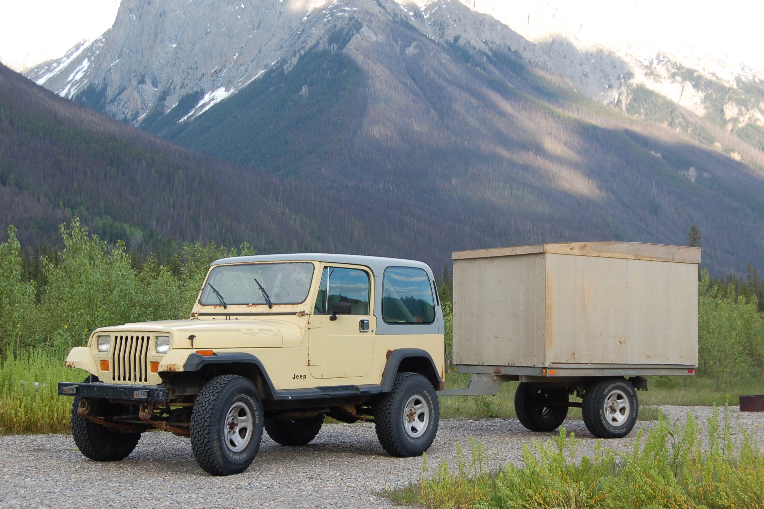

One of my early Jeeps, 33/9.50R15s on the Jeep, 30/9.50R15s on the trailer. Done for the look.
