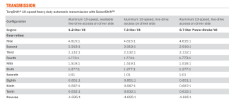

There are numerous websites that allow you to calculate rpm at various rear gear ratios, transmission gear ratios, and tire height. One example is here:
The 10 speed transmission ratios are shown below.
And if you are in 4-wheel low the transfer case is ratio 2.64:1.

Skinhyfish
A few examples:
- 33" inch tire, 3.73 rear gear ratio, 0.632 10th gear ratio, at 75 mph = 1,800 RPM
- 35" inch tire, 4.30 rear gear ratio, 0.632 10th gear ratio, at 75 mph = 1,957 RPM
- 37" inch tire, 4.88 rear gear ratio, 0.632 10th gear ratio, at 75 mph = 2,101 RPM
Keep in mind actual tire sizes are usually shorter than advertised.
37’s and 4.88 with fulltime flatbed and camper, RPMs doesn’t look to bad or far off from 4.30. Could help with climbing passes
